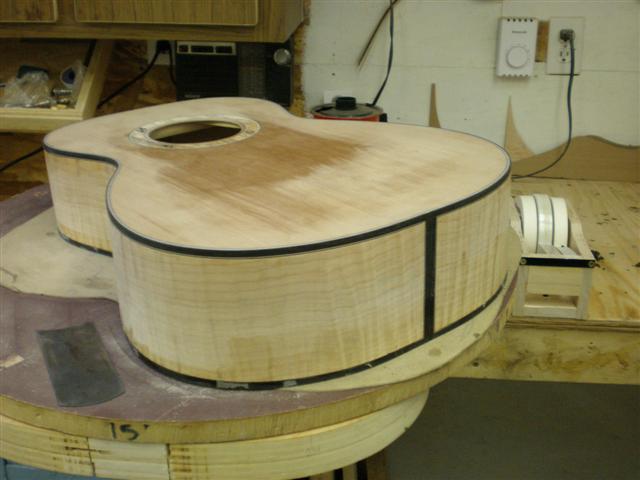

Hesh's dirty shop and lack of side purfs. lead me to start this post.
I have not use side purfs. in almost 25 years unless They are asked for by the player.
I do not like racing stipes on my guitars anywhere.
And some types of purfs look like them.
I was asked by a college student on a budget 30 years ago if they were necessary for the "tone" of the guitar!
And if it was more work for me and more cost for him!
So I started eliminating them and NO ONE has ever said to me "where are your side purfs" !
Players could give a hoot!
I've asked all my clients if they are wanted or thought they were needed.
99% say I do not care-I care about tone & playability!
When I do use them I use natural woods -not BWB -or WBW
The real wood looks much better and falls in line with a well made guitar!
Just my observation on side purfs!

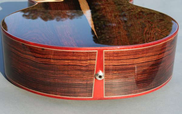

PostPosted: Wed Sep 19, 2007 5:40 am
If bold BWB are used I agree they look out of place. but I have to say in my opinion BWB or other thinline .04" or .06" side purfpling if miter jointed adds a refined finished look.
this is one of those things that is a personal view.

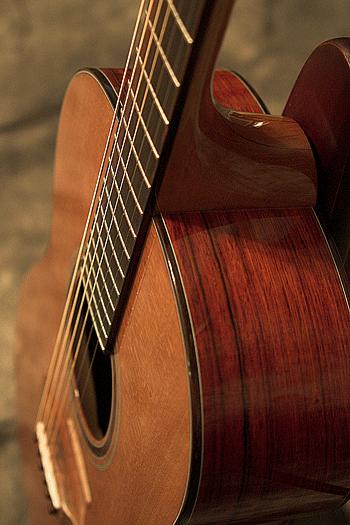

Lance ;
Is that an incredibly well cut top or what!!!!!!???
Looks like cedar!
Nice -I do like the one line purf.!
mc

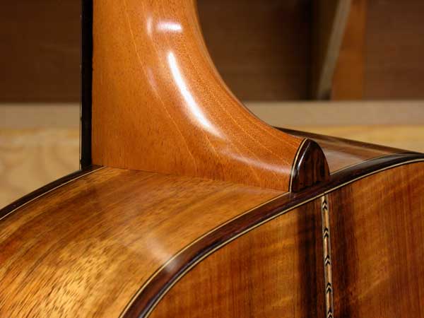

PostPosted: Wed Sep 19, 2007 2:35 pm
First off, a big round of applause to Pat Foster's side purfling/heelcap purfling detail.
Holy cow, that's not only beautiful, but perfect.
A very difficult feat to pull off--to line those up "just so"--and you did it. Great work!
